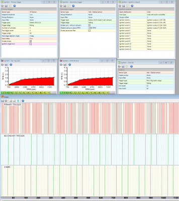

I am working with an EJ255 motor with intake AVCS only.
I finally got some good crank triggering and what I think is good cam signals too.
But my log is showing tooth out of range. When the cams advance 20 degrees, my cam
angle in the log shows -400s depending on the settings I use in the trigger settings. I tried
various tooth offset and ranges but the cam angles are either zero or negative values.
Any ideas for me to try?
Here is my scope file:
https://www.dropbox.com/s/q3raghb72smei ... ubscp?dl=0
and here is a log file:
https://www.dropbox.com/s/zm2r1gn2l2v09 ... ublog?dl=0
screenshot of triggers:
Subaru WRX 2005

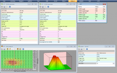

A few more things I learned that was not immediately obvious for variable cams.
6) The cam offset in the CAM#1 and CAM#2 menus can be used to correct your cam angles
after you get them to trigger correctly.
7) This one is probably obvious, but I then used the "min tooth" and "max tooth" in CAM#2 settings
to narrow down the trigger so that the cam position wasn't jumping all over the place.
8) As per tech support and my own experimentation, I have determined the proper triggers for
an EJ255 is VR sensor falling edge, 36-2-2-2. With Hall sensor, missing tooth, falling edge for the
secondary trigger. Finally, Hall sensor, Primary Trigger tooth range, with falling edge.
As can be seen in the screenshot how I adjusted the cam angles and DC duty to zero them and
at target angle 0%.
at target angle 0%.
