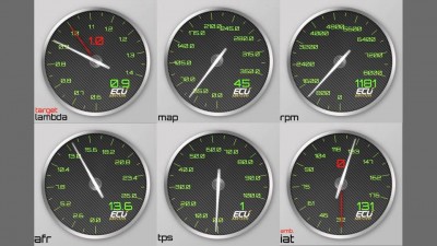

i've been working on my own dashboard. I like that I can use lambda and lambda target via the app. It would be really nice if i could also add boost target on my map gauge.
Thanks!
Adam

Sorry for the late reply. Unfortunately EMU does not send boost target in its Bluetooth stream.
