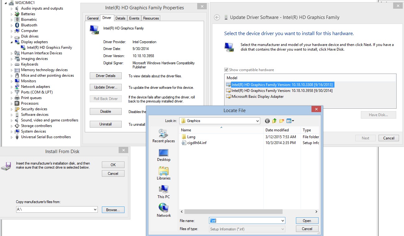

Originally posted by Wuniek
ok i managed to manual install driver from Intel web site : https://downloadcenter.intel.com/downlo ... 8-1-64-bit
conclusion is that on driver version 10.18.19.3308 EMU client have problems with OpenGL library :
the problem seems to be absent in the latest version of the driver 10.18.10.3958 :
it is to late for me to check it but i think new driver have updated version of OpenGL 1.2
Wuniek

Post by Wuniek » Thu Mar 12, 2015 1:51 pm
working driver LINK : https://downloadcenter.intel.com/downlo ... 8-1-64-bit
and manual how to install driver ( its needed when you finish normal setup with info like "contact your hardware manufacturer for proper driver" ) : http://www.intel.com/support/graphics/sb/CS-033916.htm

Post by Wuniek » Sat Mar 14, 2015 11:55 am
Hi clem,
what kind of windows are you using 32 or 64 bit ? https://www-ssl.intel.com/content/www/u ... =Downloads
the whole "trick" of manual install is to chose option "Have Disk..." and point location of files, when you once install driver manually next time you start windows you will can start normal setup.exe from intel driver package to add Intel Graphic Option control panel
if you have further problems with driver i suggest try to look driver via Vendor and Device Lists : http://www.makeuseof.com/tag/how-to-fin ... device-id/

Post by clem » Sun Mar 15, 2015 9:56 am
Hello Wuniek - IT WORKS
Big thanks!!! One thing I miss in your description was, that search manually on the computer for software has to be selected twice to get to the "have disk" button.
I had to try several times until I finally found the window from your picture.

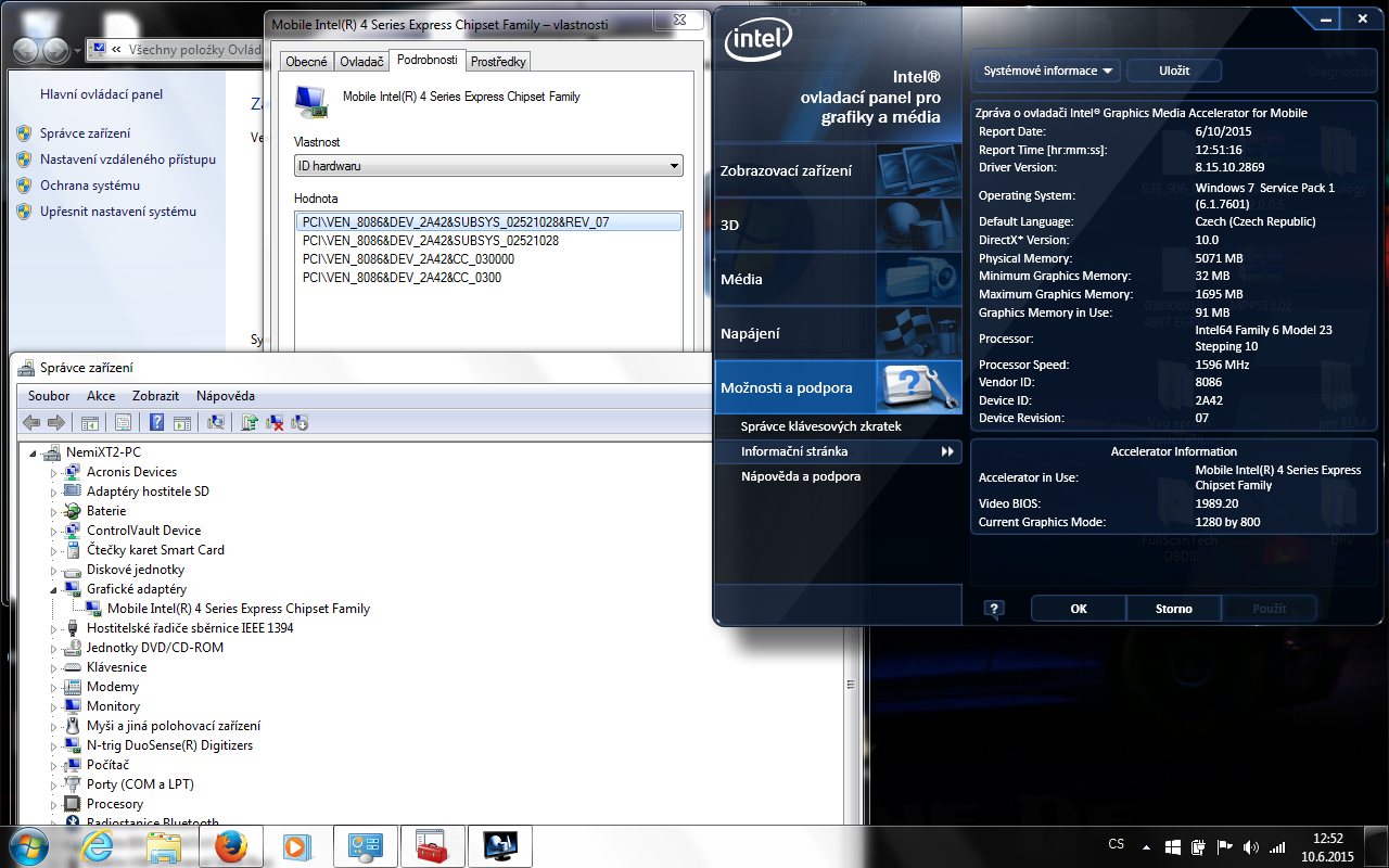

Post by nemitom » Wed Jun 10, 2015 12:02 am
Please consult the driver for me. Dell XT2 with W7 64bit.
My graphics card is a Mobile Intel (R) 4 Series Express Chipset Family (ven_8086 dev_2A42)
I tried almost all versions, but unfortunately. The only driver that works (not full) is original from W7 ver. 8.15.10.1749 (WDDM 1.1)
driver version 8.15.11.8688 not find, please sent link
thanks

Post by Wuniek » Wed Jun 10, 2015 9:10 am
did you tried 15.17.19.64.2869 (8.15.10.2869) ?
https://downloadcenter.intel.com/downlo ... ta-64-zip-
did you tried manual install of drivers instead using setup.exe ?
PS.ven_8086 dev_2A42 is G45 Intel chip ( https://downloadcenter.intel.com/produc ... ss-Chipset )

Post by nemitom » Wed Jun 10, 2015 12:54 pm
yes I used the manual installation.
But without success. Not working.
Gauges are now in order. (Background)
Thank you for your help
edit:
8.15.10.1749 - work and bug (Windows 7 orig. drivers)
8.15.10.2302 - not work
8.15.10.2869 - not work
can not be error somewhere else?

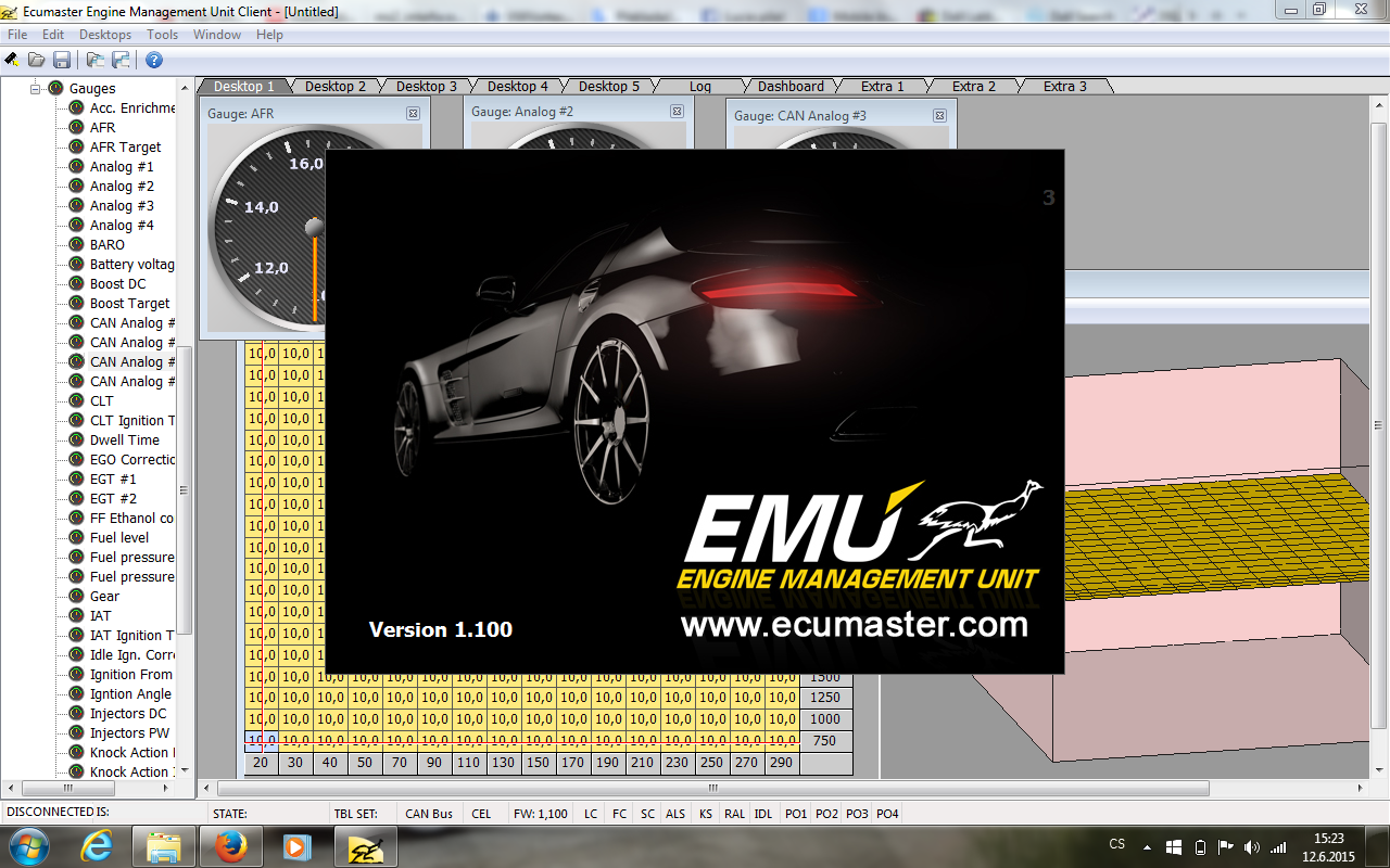

Post by nemitom » Thu Jun 11, 2015 1:07 pm
Im tested
orig W7 driver
viewtopic.php?f=19&t=3&start=326

Post by Wuniek » Fri Jun 12, 2015 8:34 am
really? version 1.000 and 1.113?
try to install latest official 1.1 and later test version 1.130 EXP 2, there was few changes after official 1.0 in client display method
nemitom wrote:Im tested
orig W7 driver

Post by nemitom » Fri Jun 12, 2015 3:26 pm
yes really!
version 1.100 is full worked on Windows 7 driver.... new beta 1.300 not work....
