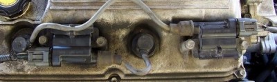

This version is without Dizzy and it comes with CAM and CRANK sensor
below image is the reference of the coils
Is it possible to advance and retard timing using DET3....
